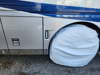

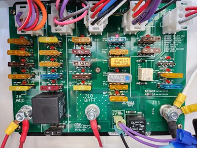

I've searched google, this forum, Newgle, manuals, and other places but I just cannot seem to find out which relay up in the front electrical basement is supposed to be for the docking lights. On my new 2023 Newmar New Aire every time I press the docking lights switch it glows for like half a second then I hear a pop to the left of the drivers seat and the docking light switch light goes out. Sure enough, when I open the electrical bay below the driver's side window I see the LED lit up on the KIB just above the 15A fuse for the docking lights indicating I've blown the fuse. Replace the fuse, try again, pop.

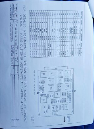

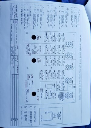

I was hoping if I could locate which relay is for the docking lights I could then test to see if I have a short on the switch side of the relay or on the docking lights side and then perhaps trace it down further myself from there.
Anybody able to point me to the diagram or photo of what relays control each of the 12V switching functions?
