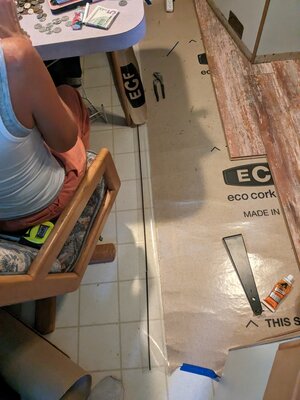

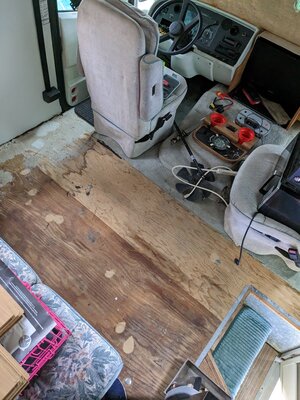

Well as soon as I get all the necessities working such as the hot water and the LPG detector working and a couple others . I'll start on cosmetics the floor will be first . But for now I'm just going to clean at it . 😆
Waiting for oldman winter to take a break. Waiting for some decent warm weather 😆
Well when i
Do the fridge before the floor. Getting the old out for the new could damage the floor.
Good idea if you have help you shouldn't have a problem . I did mine by myself and did very minimal damage to the tile floor . Getting the old out no problem because it was a small dorm size about 3' high regular house type.
The one I put in was a full size unit a Dometic freezer over fridge . I had to cut the opening to make it fit . It went fairly well and works flawlessly . Works just like a house unit once it gets going . ☝
