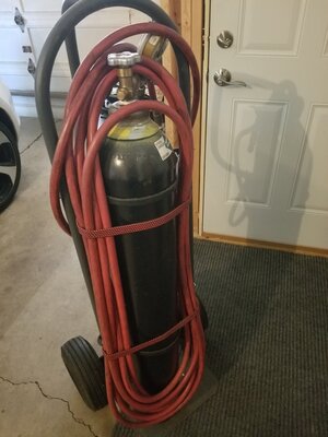

In place of the $300 charge the OP has listed, I would consider buying (leasing) a nitrogen tank and just use it to add air when needed. Provided you have a place to store the tank.
It has been so long, I do not remember how much I paid for the original tank. However, the last time I had the tank replaced/refilled, the cost was $54 for a 2500psi, 4 foot tank. That was almost 2 years ago and I have a little less than 1000 pound left in it, so at least another year. There are a number of different outfits that sell/lease nitro tanks and usually ,you cannot interchange one with the other.
I use the tank to set tire pressure for the coach, trailer (tandem axle), car, truck, and even the tractor! So it gets used a lot, but it lasts a long time (3yrs). With a trailer in tow with the coach, the tank stays in the trailer. This option may not be for every one, but it has its utility.

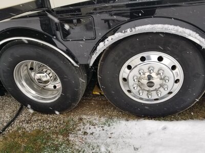

You can zoom on the tire picture for the drive axle and you can see the thread is pretty low. This tire is the original for a unit about 7 yrs old and 75k miles. The coach/drive tire is also towing a 9k# trailer, so a great deal of extra load on the drive tire.
The coach has been outside in its entire life and exposed to temps of -15F all the way up to 100F. Gone x-country every year. A tire properly maintained and pressure set according to corner weight, that tire has a good chance to live its normal long life. The nitro has been an investment well worth its cost.

Joe Hogan, there are light weight foldable dollies. Generally these lighter dollies are for luggage. I do not take my nitrogen tank with me on trips it is the 90 pound tank. A folding luggage dolly would be perfect for a 20lb tank. I use an old oxygen tank regulator. The regulator set has a 4000 primary gauge and and a 200 pound regulator gauge. Fresh and full nitrogen tank will be about 2500 pounds. Make sure the regulator will handle pressure that high. If I would need air the coach has an air tap from the air brake system. The air brake system is dry air.
I do carry an air hose long enough to reach the back tires and the towed vehicle. Sometimes other campers need air also. I rarely ever need to add air on a trip, but do monitor with 10 tire pressure and temperature monitors. I keep the air hose coiled in a five gallon bucket with the quick attach. Also in the bucket there should be an air pressure gauge.
