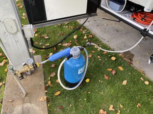

I have this one: 1573844951143.png. The instructions state
Regeneration should be performed when the hardness
from your system exceeds 3 grains per gallon as indicated
on the supplied water test strips
. I use it every place we go. I probably should back flush it since I forget about that and have never done so.........

I was thinking about getting the On the Go...are there some advantages to the Flow-Pur?
I don't know if there is any advantage of one over the other. Mine is a 10,000 grain unit and regens use 2 pounds of salt per.I usually only dump in one container. The round containers only hold 1lb 10oz so I regen slightly more often. I certainly don't want to go without it.
