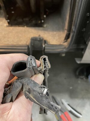

Rich, I just got same thing from Newmar to do this week. Do you cut the remaining part off the use an adhesive with the new one? Seems like the metal lined part is still there…I took a pic of the new gasket cross section… hope this helps.
Got it. Looking at your cross view, the bubble is what is torn off mine. Be back in few days thx.No... I left it intact and used that section to slide over the ridge that the current one is attached to. If you take the old one off, it might be more obvious on how it is attached.
