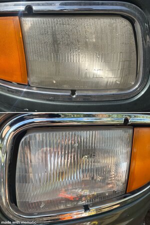

A couple of days ago I tried a headlight polishing kit. The result is great. Looks like a new light. This pic shows the left side already done and the right side not done yet. I used the Maguire one. I suppose any one would work.
I did that to mine and they came out good.
