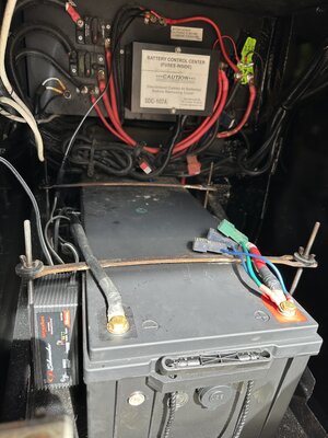

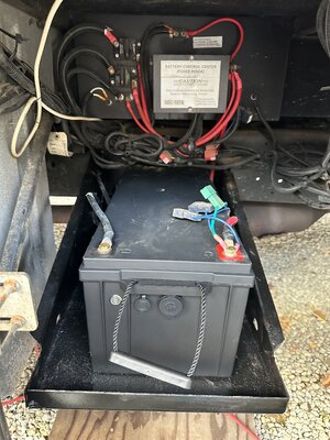

I’m not sure if you really half to seal it unless you’re going to use the Rv in extreme temps or the battery compartment is vulnerable to debris. I did do mine with thin metal sheets I could bend by hand and self tapping sheet metal screws.
Good point, I'm not sure where the "seal the bay" comes from, I don't think it's required other than for temps. But you can take the opportunity to make it a great bay for storage, etc. as I gained a lot of storage space in mine. You could get creative and build a battery box, etc. I believe and that would work which is what ended up happening with mine simply to enclose them as they don't need to be vented like AGM/FLA require.
