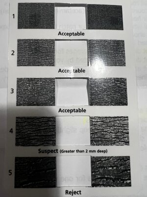

I got this from Michlien Tire that shows acceptable cracking since I didn't know what was the definition of unacceptable checking/cracking. Mine are between #2 and #3 put with date code of 13 week of 16 and the coach went into service Sept 2016 with 33,000 miles on the coach. We are going to replace ours after our Florida Trip returning May 2023.
