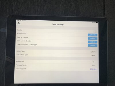

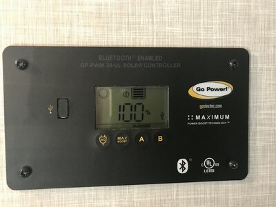

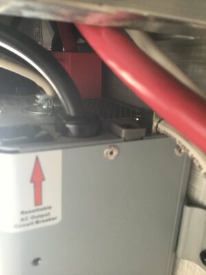

Hi Bob. So you wrote all the contracts between Manufactures and dealer. We’re do you find the time? Since most coaches sit on dealerships lots for months wildling down on any end users claim time for claim against manufacture responsibility. Question Bob is the manufacture responsible for assembly of components provided to dealer to function as a fully functional compatible system? Or is the dealer responsibility to make it right? What we have created here is known as the great escape for both parties. Dealers and manufacture. Not such a good job for the end user. PS. To all Go power and WFCO are not compatible to interface together “quote Per Go Power Rep” Call them. Notice in pictures how they left out the cable between inverter and controller. Yes the cable comes with inverter. Someone needs to make a state for what is right even when owners didn’t make that agreement. How about some end user opinions .

Yes Bob that is all fine and dandy. The Problem being is that when you Factory started selling a solar system with inverter you also took the obligation to provide consumer a fully functional system. If that means using a different inverter than WFCO to provide in coach control of inverter at control center then so be it. WFCO inverters come with cable and remote control. I’m my case this wasn’t installed. Normally when production install inverter there is a remote at the control centers. Not the case here. I c cannot get the factory to agree to correct the matter that they have assembled a incompatible mismatched electrical system that doesn’t interface together. This is not what anyone would be expecting or wanting Or should expect. Before any dealer can work on coach dealer has to agree to make the corrections. They won’t. They lie and say “ Ready Accessible “ It just so happens that i am handicapped individual.1st of all all WFCO inverters come with interface cable and remote.Factory didn’t install a. Then they say that Go Power inverters are unreliable. I think that is opinion some might say a lie. As i see it if it goes to a dealer for repairs Forest River deny correcting electrical fi and fix the 13 other problems to there specifications factory warranty runs out. Then what happens?? I’m @#$KED!! And they continue peddling Lies, substandard coaches with a mismatched, electrical system that doesn’t work due to incompatibility problems because they don’t interface properly. Question Bob how would you proceed from this point? Would you agree when Forest river decided to offer solar option it was there obligation to assure system function is per owners manuals provided with coach. That isn’t what I have. They don’t want to fix it? Don’t seem right to me. Customer Satisfaction What a joke. Customer last concern.

Thank you Bubblehead.That is exactly what I am trying to . As anyone can see this isn’t right. It is there responsibility to provide a fully functioning compatible electrical system that interfaces correctly with all components installed. Maybe the should bring a electrical engineer for the engineering of what they are pushing out to unaware consumers. Then spew deceptive falsehood statements to get out of there responsibility. If anyone else has this issue please chime in. Thanks for all the help.

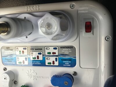

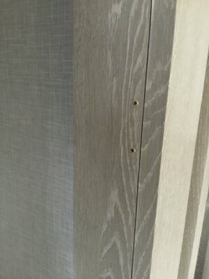

1) Window valances were either missing fasteners or had been stripped from being overnighted. Then they put screws in wall next to bracket to temporarily hold it to wall. (2) Glass stove cover hinge fastener fell out while traveling. (3) Refrigerator light doesn’t stay in wall of refrigerator Faulty tabs wont hold. Refrigerator also runs hot while in travel on propane 54+Degrees. (4) Sewer Black water valve doesn’t seal properly every time I remove cap outer a cup of raw sewage comes out. (5) Water pump switch in compartment Quit working. (6) The controller center A/C inverter Button on controller Doesn’t turn off or on the inverter. (7) Closets Doors are missing catches to hold them in place during travel. There are pilot holes in frame but no catches. Don’t no how long they are supposed to last. (8) Celling fan blade bracket broke while traveling. (9) Front compartment Led light switch has failed. (10) Protruding screws were LP Hose connects for outside grill. Ouch! (11) Trash and screws left in floor ductwork. (12) Wood trim at some cabinets stamped with excessive gaps Exposing raw wood. This leads one to question Quality Control? (13) Gouges in flooring covered up with Repair Tape to cover up.
