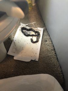

This guy was headed toward the RV last time we were down - a week ago. We blocked his path and made sure he was headed the opposite direction only to find he made it in anyway. Hubby has been all underneath RV looking for holes. Any suggestions on where else to look? This was behind the toilet in the bathroom.

Wow! Path in is where any ground contact OR if you have tree limbs allowing them in from above. I'd probably burn down my RV!
We found the drain pipe in the bathroom (where it goes through the bottom of the coach) was not sealed around the pipe itself. No snake activity, but a mouse had been making the rounds. A little Great Stuff fixed the problem. That and a mousetrap.
Will check that! Thank you! Someone said powdered lime will repel them so will hunt some down. Just hope this one didn’t have any friends!
