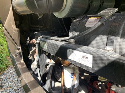

Just for giggles I went out and took a photo of mine at an angle so the vin isn’t readable. It is riveted on a steel member in the engine compartment that could be removed very easily by removing 6 bolts. This is on a Freightliner chassis built in 2016. I wonder if this is compliant?

Maybe ..:: maybe not, but at least it has one.
I believe there are more places too for the tag on Freightliner. I remember one underneath when I was on the rack at HWH, towards the tag axle near the air dryer canister.
