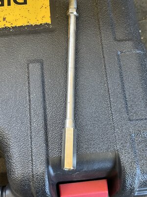

Regarding checking tire pressure on the inside tire of the rear duals, can you easily reach the inside valve stem with the typical trucker extension air chuck?
