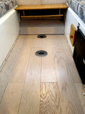

I installed PERGO MAX Hardwood in our previous travel trailer. Removed all of the carpet, cleaned the floor, and roughed it with my belt sander and #80 grit. Vacuumed it out, and wiped it down with mineral spirits. Using recommended flooring adhesive, I started installation in the longitudinal center. Each piece was fitted into place and then using my 18 ga air nailer put a 3/4" nail every 12" or so in the groove. Then on to the next piece. Looked great and still looked great when we sold the trailer some 5 years later. IMG_1502.JPGIMG_1510.JPG
I installed PERGO MAX Hardwood in our previous travel trailer. Removed all of the carpet, cleaned the floor, and roughed it with my belt sander and #80 grit. Vacuumed it out, and wiped it down with mineral spirits. Using recommended flooring adhesive, I started installation in the longitudinal center. Each piece was fitted into place and then using my 18 ga air nailer put a 3/4" nail every 12" or so in the groove. Then on to the next piece. Looked great and still looked great when we sold the trailer some 5 years later.View attachment 16794View attachment 16795
Looks great! Nice job.
