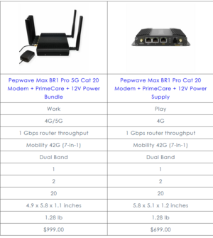

Each of us have a different need and "use case" for our Internet. What I need can be very different from what you or others need, or want to spend. I run a tech business, my needs and desires are different. For some, hot spotting off of a phone plan is sufficient, there is actually a good amount of data available there. Others may use a jetpack type setup from a cellular company. I want to have all devices in my coach dealing with only one Wi-Fi source (TV's, phones, tablets, Amazon Alexa's, Thermostat, Pellet Grill... and ...) so it comes to a simplicity in management for my needs as well.
Each person needs to determine their needs and budget and go from there. In your attachment, both are great options.
