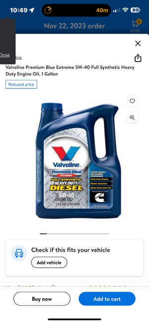

IMG_0923.pngCummins approved, this is what I use. Not sure that a 15w-40 is necessary for my usage.
I'm using Rotella Duralec, can't remember the specific type. May want to ask at the oil change what is being used.
View attachment 21890Cummins approved, this is what I use. Not sure that a 15w-40 is necessary for my usage.
Sometimes, it's not about usage, but about components. Be sure what you use for oil weight, is in line with manufacturers spec for conditions vehicle is used.
