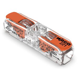

I’ve been using these lately. Very positive, reusable, easily tested, and if you aren't sure about the connection you can just open it back up and reset the wire without losing any - important when working with limited wire. They take up more room than a butt connector so they aren’t always the best choice, but when you have room for them them they work great.

We use a lot of wago's. Haven't had one fail yet. They make longer inline ones if you need to come in from 2 directions with short wires.
Thanks for the tip - ordering a 48 pack from Neal’s store now
Wago is the "gold standard", but sometimes hard to find. Lowe's carries Ideal, which has a competing item in reusable lever wire clamps.

I have had issues with WAGO when I switched to them in my OASIS rewire after the shorts I had from Newmar's install issues cramming wires in and stripping insulation in the process. Not sure how one had a short but I think the important message is to make sure you size your wago connector properly. Know the ratings of the connector and use the correct one for the task.
