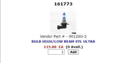

From The Newmar Parts Catalog the 2024 DutchStar headlight bulb looks to be a Sylvania Vendor Number #9012SU-2.

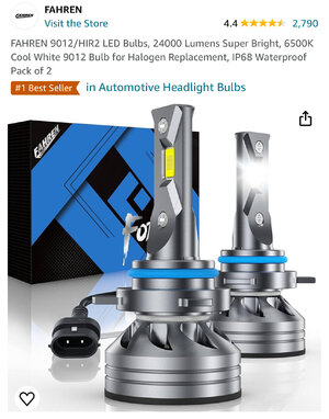

Thought I'd try these
Amazon product ASIN B0CLGY6PNR
And a review
From NEWMAR Parts Cat.
9012 is the same for 2023

Ended up purchasing and installing Fahren bulbs. They seem to work well. Fitment not an issue. Went right in.
Just to tie up loose ends. The Fahren LEDs expired early. Six months and LED is dead.
Not sure if it was vibration, the harsh ride, or just QC, but one died.
Back to Sylvania Silverstar for now.
