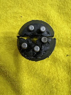

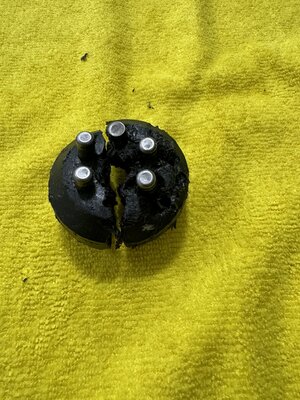

I had a full wall slide failure on my 23 DS and I Have been helping Rustycoach with his 20 DS
It turns out he had the same failure as mine. There is a part referred to as the Revolver gear, it’s a plastic wheel that has pins in it ( looks like a revolver with bullets)
This seems to be happening more frequently on newer units.
Here is my PSA: a Newmar technician had said that one of the things you should avoid is putting the FWS partially out, and then returning it in without having fully extended it. This change in direction creates a surge of pressure that the synchronizing cylinder can’t keep up with when it starts to move that puts undue stress, particularly on these revolver gears. They did not say this was absolutely the cause but could be a contributing factor.
The revolver

For those that are interested, here is a drawing showing the Pinion gear that is known as the Revolver. There is an anchor pin that is threaded at one end into the end of the hydraulic cylinder. Mine was loose and it was ripped out of the threaded boss and destroyed. It destroyed the cylinder and the pinion. I am working with HWH on a replacement plan. There is no easy way to access this to lubricate it. This is a cool machine but from an engineering stand point it could use some beefing up. If they do not replace this under warranty, I will use my resources to design in a more robust pinion and attach.
