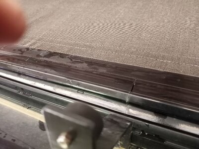

Thanks for the responses. I have done all those things suggested. I pulled the coach in my shop the other day and left it dry out real good. Then I put the slide out, drivers side, put my ladder up against the front side and got up there with a flashlight and water hose to see what might happen if I sprayed water over top of the slide. YAHOO !! I found it. There is a long channel that the slide out fabric fits into. This channel is in 2 pieces, being butted together right behind the bracket about the dining room window. There was a 1/8th inch gap in that joint and the water was pouring in there onto the top of the slide out. I sealed it with Flex Paste and now it is fine.

I'm trying to attach a photo of the problem before I sealed. You can see the gap and it goes down over the leading edge also , you need to seal it all.
