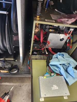

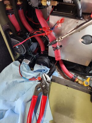

My visit to ITR went well and they had me fixed and back on the road within an hour. My Oasis on my '23 New Aire is of the newer design so the pumps were easily accessible behind the front cover. Given the rig was only 2 years old and had only 249 hours on it they did it as a warranty repair with no $ out of my pocket. Noice!!! That said I did buy a pump from them to add to my spare parts tub in the basement.
Their staff was extremely courteous and let me watch them do the entire repair so I could do it myself in the future should I need to while on the road.

Boy, I sure wish mine were that easy to get to! Did they give you any suggestions to try to alleviate pump failure?
Looking at your pictures it appears that your original summer loop pump has the gray end caps. I'm assuming the one ITR installed has the green end caps which is, according to ITR, the later version. Did you happen to ask if there were any modifications to the newer version?
Yea….i have the Oasis NE-S and it is easier to work on….
