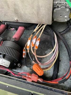

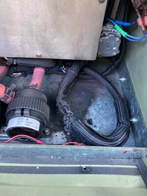

My problem was that the four wires that lead to the electrical elements burned through completely and smoked quite a bit. See picture. Keep in mind that I have an Oasis NE-s, which is the bigger unit. It appears to have burned through where there was a connection between the lines coming from the relay and connect to the elements. These were male/female connectors used and this is where they burned up. I will probably just cut the bad wire out and replace with wego connectors, but wanted to see if what ITR would say.
