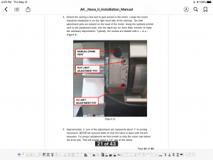

As the material stretches they will effect the alignment. There is an adjustment and you should have gotten a plastic Allen head tool to use. Complete instruction in the manual but I attached pertinent page. Only concern is make sure you don’t over adjust which will allow motor to continue to run. Easy enough to do after I watched them do mine at Girard service center.

I got the tool. Time for some reading. Thanks for the heads up y’all. I was getting all worried for no reason.
Fixed! Thanks @NWIP and @Buly. Was super simple. Just a couple turns of an Allen wrench.
