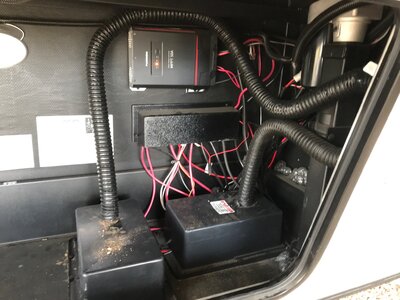

We purchased our Reflection 303 last spring and in the summer on our first trip one of the batteries overheated and we almost had a fire. The battery that overheated was replaced with a new battery. Recently the owner of the RV repair facility where we store our Reflection 303 notified me that a battery was overheating. Does anyone else have this problem or know what is causing the battery to overheat.
This is a photo of the electrical system in the forward compartment of the 303 Reflection. The auxiliary battery to the left in the photo is where the battery overheated while we were utilizing the 50 amp connection at the pedestal. I am a retired dentist so my knowledge of the electrical system is minimal.
