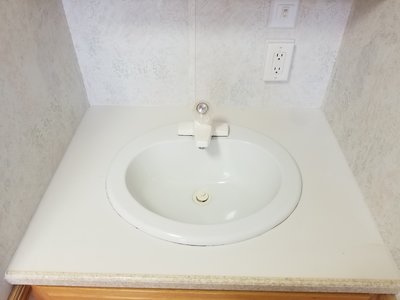

Still need to replace the kitchen faucet. Seeping water out of the handle when running. Was going to replace it anyway.

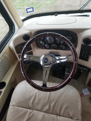

Got some new BLING for the Dutch Star!

Whoa! That looks nice!
