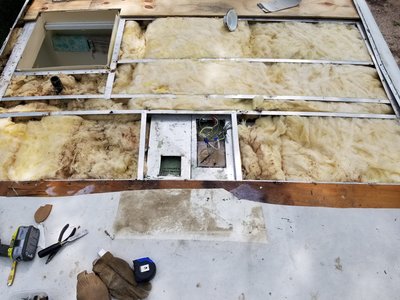

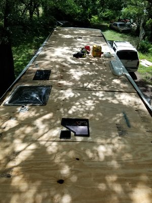

Gonna finish the roof, replace tires, and do needed maintenance.
Have some fun this summer and fall. Start the reno this winter.
Great job on the roof! If I may ask, what purpose does the steering wheel have?
Keeps me going the right way! LOL

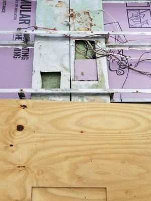

Was using it as a prop to keep water from collecting over a hole in the roof when I have a tarp over everything.

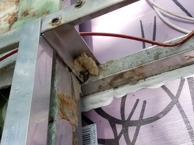

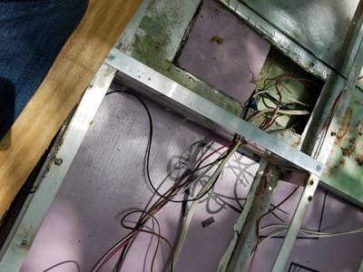

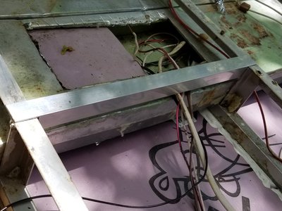

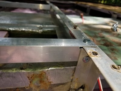

Rain in forecast all weekend so roof repair. I decided to take the ceiling repair. Got a sheet of 1/4" underlayment and a sheet of dense foam insulation. Cut them to fit. and glued them together. Glued the foam backing to the plywood, then ran out of glue before I could glue the vinyl to the foam. Will have to measure close on where to cut holes for the AC vents. Is It is going to be a challenge to get it back in place before the adhesive dries on the ceiling joist. When I get to that point.

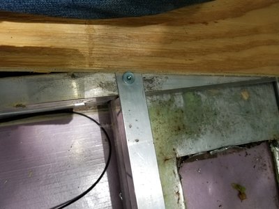

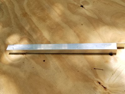

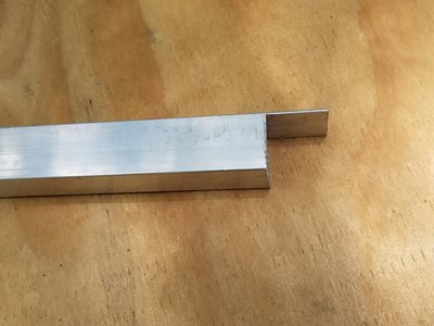

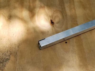

I am having to replace a section of the interior ceiling in my 2000 Dutch Star. I need the "T" strip that fits into the Channel the ceiling section fits in. Any idea where I might source these piece. Newmar does not list them. I believe a lot of coach marker use this system. Thanks.
I would email or call Newmar parts. I'm sure they can get that for you, it seems common as I look up at it in mine.
Very nice work. And I love the Porsche
Ok, I applied a little heat and got the old ones out. Can reuse them. Yay me.

Finished the replacement ceiling panel and installed it. Not perfect, but I'm good with it.
