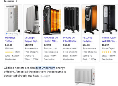

After insulating as mentioned above, you may want to get a portable electric oil heater. Works great in ours that the propane heater seldom comes on in 28 deg weather. Pretty efficient too.
