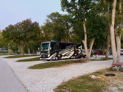

We are at Camp-A-Way in Lincoln. Thanks for the Freightliner info but we seem to be ok. Was able to get level without deploying anything so hopefully the slide will come in just fine. They look good so far.Where did you stop for the night in Lincoln?
I thought so - we stayed there too. Nice mature park nestled in the SW corner of a clover leaf, but for all that it was peaceful and pleasant.We are at Camp-A-Way in Lincoln. Thanks for the Freightliner info but we seem to be ok. Was able to get level without deploying anything so hopefully the slide will come in just fine. They look good so far.
