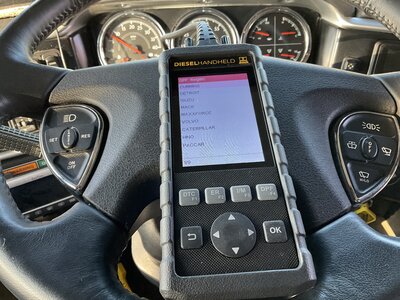

Also with a 30 day return policy you can‘t go wrong. I bought mine used for 1/2 price and cant tell it from new. Might need a firmware update, but it works just fine as is. Here’s a pic of what you get - I guess you can use it on anything with OBDII. I wont travel with the big case and all the cables - just the device and the J1939 adapter. Let me know if you have any questions
yes same thing.

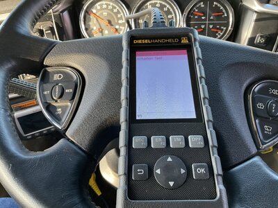

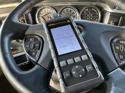

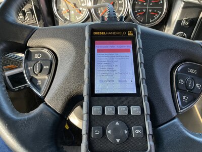

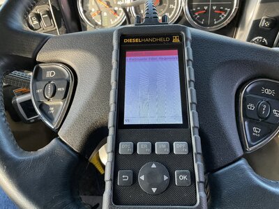

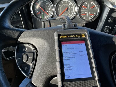

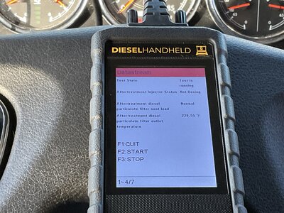

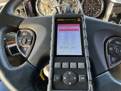

Here’s some pics from performing a parked/forced/manual regen. The last one is probably the most important to me - it shows the after-treatment doser “on” and the resultant high exhaust temp. This is a first for me and essential to confirm you're actually performing a regen.
For regens, this device is nice because the extra steps/screens give you additional info and it lets you know you’re doing this right. Also it has code reading/clearing, libraries, all that, and will read and clear codes on any gas diesel vehicle with OBDII.

The info on the after treatment doser (seventh injector) was critical to me. With OTR I don’t have data field, AND my forced regens weren’t going over around 790°. This concerned me enough to have the Freightliner shop peform a regen, record temps, amd confirm that the doser was working (the coach was there for other stuff anyway).
But still with other device I not only had no confirmation of this, but with OTR it seemed to confirm that it wasn’t working. I didn't know if this was because of a fault in the device or my coach, or becuase my DPF was at 0% soot load, or if I just wasn’t getting sufficient data. And there is really no room for confusion or doubts here.
The Diesel Laptops Handhelp came through for me as evidenced in the pics above. It confirms that the doser is either off or on, and my regen ran at about 1050° for the duration (about an hour and ten minutes) after fully heating up. This gives me peace of mind about the system function and the quality of the regen, and thus my DPF health.
So thats why I say “this is it”. I also like a hand held device that’s like a multi-meter and I like that that it plugs into the J1939 port and does not require a blue tooth connection to a ”smart” device. Guess Im a little old school here, but I just find this method much more pleasing and acceptable.
One of the nice things about this tool is that its simple to use. The instruction manual is brief and the screens are intuitive. I read the manual, then went out to the coach, plugged it in, and just explored it. It powers up with the key off so you can start by just letting it examine the system.
After turning the key on I went through the code reading/clearing functions but I dont have any active codes. So then I just went through the regen process (8 pics above). One thing to note, and maybe its because I bought mine used and its older, but there is no mention of regens in my manual. But I also found I didn’t need any instruction. Just paged through the screens and made it happen.
I’ll have to work with it more on codes, code history, and libraries, but it has what appears to be a good code look-up system and library, that includes codes for anything with OBDII - not just our SPN & FMI DTCs. Another nice thing about this is that the whole time I was using it I felt like I was using a professional tool and not some cheap home-owner code reader.
One thing that caused a little concern was that my ABS light came on and stayed on while performing the regen, but it went off as soon as I was finished. Might have a word with tech support about that. The only thing missing is regen timer running on the screen (OTR has this) but I can time it with something else. My regen ran about an hour and ten minutes.

Not really. The OTR diagnostics app will run a regen immediately which is nice, but on repeated efforts I never saw temps above 700° and there is no indicator for the after treatment injector status. The Diesel Laptops handhelp has a field for the 7th injector on and off.
Clearly though, if the aftertreatment temp reading was correct at under 700°, the “7th injector” was not operating. And as mentioned above it was reading the soot level as 0% which I’m interpreting as a non-reading. And previously OTR read my soot levels anywhere from around 20% to over 130%.
Because of this and after discussing these results with several mechanics, I went to the considerable trouble of changing my differential pressure sensor, which also cost almost $200 and had no effect. So I then paid the Freightliner shop to diagnose my emissions system and their report indicated all was well. So this was a wasted effort/expense.
The Diesel Decoder (also blue tooth) had a considerable delay starting a regen and also reads my soot level as 0%. I’ll run it through the paces again but I’m beginning to think there is an issue with blue tooth reading, at least with these two devices. It does provide a detailed report on every sensor, system, and condition, which is nice, but I’ll have to check again on regen temps.
The Diesel Laptops Handheld gave me reliable data, and performed a regen that went over 1050°. It doesn’t have a precise soot level reading but it’s good enough for me since it seems to at least be correct, and the regen ran as expected. I would reccomend this over the others.
