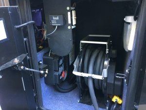

As mentioned above, you'll place this near the power pedestal and plug it into the pedestal. Your coach will plug into it. You won't need your surge protector at the pedestal but it can't hurt either. It is a little heavy so be ready for that, nothing more than your OTG water softener deal. You just need to protect it from water such as happened to me. I had it at the pedestal and didn't know it was going to rain that night, it was 1/3 submerged in water the next morning from heavy rain and also a recessed area at the pedal perfect to make a pool. It was fried! If you're close enough to the pedestal it can go under your FWS for rain protection. If not then I used a clip on umbrella, I wasn't a fan of a bag or trash can as it will need to vent.

As to your situation, it sounds like an out. If they can't provide adequate power leave and get refunded assuming you have somewhere else to go. The Hughes Autoformer is good to have, I use it 100% of the time as it's internally mounted. Buying a new coach or not it's not hard for someone to do for you and then you can forget about it. As I've said, when you know you need it it's too late so it's always inline for me. I'm glad your AGS settings are doing what they need and don't worry about running the gen, it can sure use some exercising I'm sure. I just ran mine constantly for the past 3 days while at the airport.
I would buy the internal mount kit and just store it for when the opportunity arises for you tocon ask someone to install it for you.
