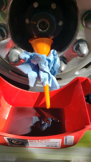

Rotate the wheel so drain port is facing down into your funnel...prop with paper towels...and give it time to drain. It is time consuming...but not labor intense.

Prop your catch pan up...for some reason oil spits out of the end of the funnel...and if it has room will go over your catch basin onto the ground. I learned to set the basin up atop a tackle box...keeps it from spraying oil all over.
