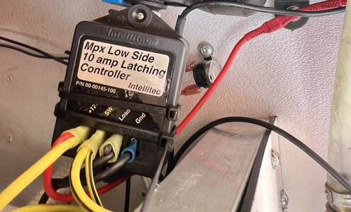

Here is a picture I pulled from my phone pictures history, if it helps. Upper controller is water pump, don't look at bottom one for custom sanicon control.
Thanks Neal. I will compare it to mine.
Here is mine. I even run a special ground wire to the GND spade. Maybe I have to hunt for the two white wires?
