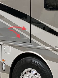

Any of our techniques would not produce the ridiculously “perfect” line/bead/edge of caulking on the trim pieces of my DS slides.
Now, the windows and doors and pretty much everywhere else...yeah...the ol finger would be fine.
Next time, take a look at these places and you tell me!
