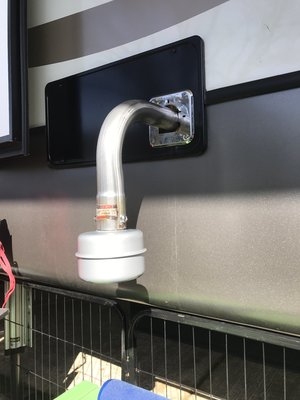

I did assemble this 90° exhaust pipe with a lawnmower style muffler, it seems to work pretty well and still provide enough ventilation. Any thoughts of unintended consequences with the set up?
I would be concerned about the heat retention in the furnace causing a premature burn out of the heat exchanger.
Not to mention the increased back pressure causing an incomplete burn and increased smoke/soot. Gas furnaces are more complex in operation than it might appear.
I have exactly the same problem with my Dometic furnace on a 2021 Lance trailer and considering a similar solution. Early this year, around 10 pm, a campsite neighbor shouted into the dark “Shut that f*&king thing off”. It is a very loud “bass note” harmonic and if I’m listening for it, can actually hear the furnace when I’m more than a hundred yards away.
Rhickish, where did you get the 90 degree bent tube that fits the furnace exhaust pipe. I was thinking this alone might change the harmonic and quiet the furnace down. Directing the sound down would also be a big help
