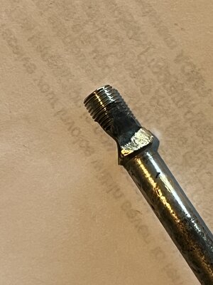

This is not a new problem. It happened on my 2016 FL chassis Ventana and very nearly wore through the extension before I noticed it. When I did the stabilized was just hanging on the extension outside the slot in the wheel and the extension had been wearing on the inside of the wheel slot. My remedy was new extensions (around $20) and new stabilizers (around $9 each) and I used VHB tape in the groove on the stabilizer to keep it stuck to the wheel. I still checked them before every driving day but never had the problem again.
Reportedly the stabilizers have been improved and a new version is available. The guys at the FL shop hadn’t heard this but I bought new ones anyway and always carried a couple spares and spare extensions. I explained all this to the new owner when we went over the spare parts bin so he knows to watch them too. If you look at the second pic you can see that it was very near failure when I caught it.

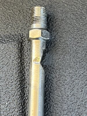

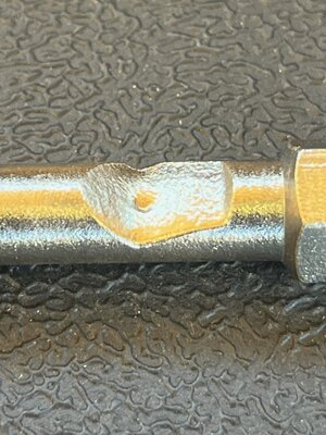

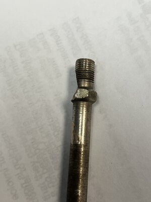

It has been well over a year now since I last checked, (see my yet another tire blowout thread) but at that time Freightliner had recalls on every individual chassis line they made going back 5 years over valve stem extensions. Even though I had the physical evidence Freightliner claimed my particular VIN was NOT in their database of VIN's in the recall they refused all responsibility and accused me or the original 80 plus year old owner of crawling under the motor home and removing the safety equipment. Cost me two tire blowouts, months of downtime and thousands in damage that fortunately my insurance picked up. Very disappointing to hear they still havnt resolved. I will never again buy a Freightliner product due to their dodging responsibility.
any evidence your blowout originated from a stem failure?
Yes, I still carry as a reminder the remaining stem from my "in for repairs" coach that was chewed through and would have duplicated the original stem failure within a few hundred miles at best. I posted photos on my tire blowout threads of the remaining stem and the damage that was caused. Just got an update Friday that the 2020 that lost the steer tire was ready to be picked up. It went into the shop on July 31st of 23.
Update - I just realized my most recent thread is about the steer tire blowout, obviously not an extension issue on that one. The previous tire blowout thread I have DID result directly from the extension debacle. Sorry if I confused anyone.
