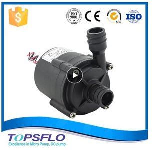

I won't, I won't! I promise, I won't!Then there is this - pic of the horrible retro pump with 3/4” fittings
Lest you ever consider such a thing….. I’m sure you won’t. A few of us acted as guinea pigs and proved beyond doubt through the scientific method that this is a bad idea!
