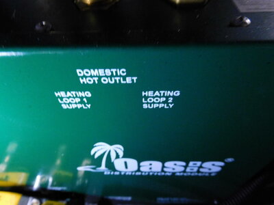

Changing the pumps in your coach would not be hard as you have big basements. The pump location is accessed from the passenger side and you'll likely have to remove one of the wooden "faux" walls on the back side of OASIS or shore power reel, I can't remember which, for me it was the bay forward of the pegboard.

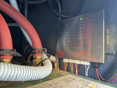

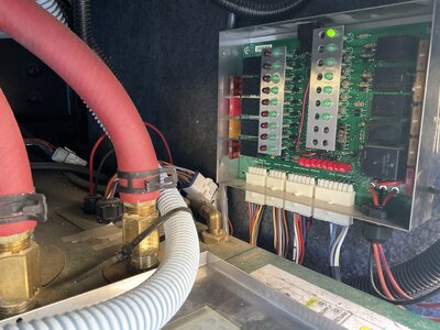

ITR Heat is great to talk to if you need troubleshooting advice. I've done far too much triage in mine from electrical shorts, failed pump (so far only 1) and then of course the annual service kits which if you don't know if yours has been done I recommend picking up a 5 year kit.

Have spade connectors and spare fuses on hand as well.

Hey Rich, were exactly are these fuses?If you change the fuse and it immediately pops the new one, you have a bad (stuck) pump.
