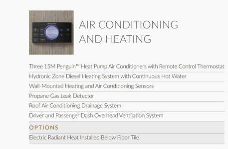

Just looked at the brochure and you have the same thermostat I have. So just hit the mode button for each zone until you get to Heat Pump and set your temp. There is a short delay but it will come on and start blowing heat in a couple minutes and they really put out nice heat.
From the 2016 LA brochure: F6F7A96C-8EC0-482A-9552-5161CEAE8E4F.jpeg

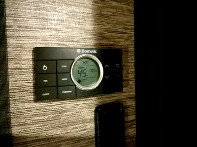

Mine looks like this with the heat pumps selected:
From the 2016 LA brochure:View attachment 15690

I have a silverleaf and unless the "mode" is hidden somewhere, I'm not seeing it. And for some reason the heat pump isn't coming on. Maybe because it's below 40*?
They are not very effective below 40 but should work. I recommend getting some heater hose so you can replace, I imagine yours is probably hard/stiff due to age. I measured and put on hose on new pump prior to disconnecting the old pump and hose. I also recommend a pair of hose clamps and lots of rags.
I also recommend the US Solar pump @Rich W. suggested, it is identical except you need to put on the electrical connectors.
@Jim there is logic in the systems that at a certain temp somewhere 40 or below they will auto switch to furnace. Mine does it at 32 which is too low but I verified it works.
