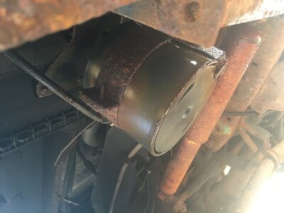

Alot has ensued since my last post Indeed I have had the good fortune to find a mechanic with Army experience, he was able to remove the dust panel and get the hardline out, without jacking it up or turning the wheel, it helps he’s only 5’6”. I had gone to Oreilly’s prior to his doing that, but instead of ordering Hydroboost to gearbox I ordered the wrong hose, I was able to get the correct one same day since they had in the store but unfortunately the fitting diameter is not big enough. So the other mechanic who works with him also military experience in the Navy, he tried using some JB weld muffler for a temporary fix till we could locate the correct hard line, which I was telling them unless we can locate a Chevy OEM part it will most likely need to be made at a hydro shop, I argued it was a high pressure line and it was not likely it would work, it cured for a few hours and than tried with the engine on to bleed the line but it didn’t hold. So the mechanic is on the lookout for a line and I need to start calling hydro shops. I put some regular JB Weld so I’m going to wait for it to cure for 24 hours and try again. Glad to say the drive shaft is back on. I’ll keep you posted on the developments.

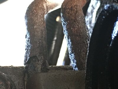

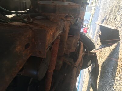

New development, the good news there is a tiny drop leak now from the hard line the bad news there is a new leak closer to the passenger side leaking profusely power steering fluid, power steering pump? Or is that ATF? Haven’t been able to tell. I took some photos of where it is so should be easily identified, ATF for sure smells same and dipstick is low.

probably a trans cooler line. That is one rusty rig man.You need to go over the brake lines and cooler lines etc.
It does not look good
I agree with latech. I don't want to discourage you but those lines are your BRAKES. You shouldn't be trying to repair them with JB Weld or some kind of liquid stop leak. You're going to get yourself killed. As rusty as those lines are and as rusty as that hydroboost system and master cylinder is the only thing I can recommend is to replace it all. Every piece of it. Replace all the lines with new one also. If this sounds like something that is too expensive then stop what you're doing and move on to a different project. You can't jerry rig your brakes system together. You just can't.

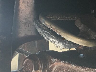

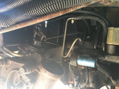

it’s a rust bucket it sat on the Oregon Coast for almost a year before we bought it and before that it was in Montana so it’s seen it’s share of salt. We didn’t have much affordable options available after losing our home. Not much I can do about that, we don’t really move around in it much it’s more. a trailer to us than a RV. Edit I pinpointed it to a line that goes from upper radiator to what I believe in the picture is the transmission oil cooler? The lines are not easily replaced if I can find it. That part of the line is known for rusting a lot. There is a quick fix with hoses and clamps but the line has to severed to do that and so far it’s not a big hole, so since I still have some JB Weld left I decided to see if I can at least plug the leak till I can figure out my next move I’ll give it 24 hours to cure and see if it worked. It’s not as high pressure as the break boost line, so maybe it will hold. Will keep you posted.

Sorry forgot to post an update, I finally got the power steering line made at a place that does hydro hoses recommended by Freightliner, cost 80 bucks, since part of it had to be welded, hooked it up no more PS leak, as for the cooler line no surprise as soon I drove a couple miles it started to leak again. I bought a flaring tool kit at Oreilly’s but I haven’t bought the tube bender, for some reason my brain didn’t process they are two different tools. I’m now on the beach 3 miles from the campground and I’ve been putting JB Water Weld on, it’s supposed to withstand the PSI and can take up to 300 F, do the lines get that hot? Last night as a temporary fix to not lose anymore fluid I put some JB Quick and some Water Weld over it. I haven’t tested it yet will have start it up soon though. I know I need a permanent fix, I also bought some heater hose and clamps and a tube cutter in case I might try to splice it till I can make my own lines , Thanks
trans lines can get that hot. But not too likely unless you are really working it,like a long grade or something.

I’m glad to say that the combo JB Kwik and Water Weld, held up we made it back to the campground with a tiny leak. The lines are definitely hot to the touch ouch, I was studying the lines and the one that is leaking is the one that connects to the upper radiator that’s going to be the challenging one, the other one from the trans cooler isn’t that much of a challenge. Well I have to move as quickly on it as possible as we are in storm season now and need to be ready to go in case of a bad storm. Thanks
