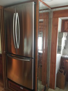

The inverter converts the 12v house batteries to 120v for the 'fridge. No problems. The 'fridge compressor doesn't come on much at all while going down the road, unless someone is back there fanning the door. ? Gotta tell them kids to get everything they need at once
Not at all. If you keep the doors closed the temp will stay cold for hours and hours. We live in the South where it's 90 degrees outside most of the Spring/Summer/early Fall so we run the generator so we can use the house A/C so the house batteries are being charged anyway. If the day is cool and we don't need the house A/C we leave the generator off. The house batteries are OK because the compressor on the 'fridge doesn't come on much. If you'll notice, most new Class A coaches are all electric now. Most also come with a residential 'fridge just like we have.

My fridge only runs a little on hot nights. otherwise it stays off unless we open it a couple times after the sun goes down. Only seldom will the batteries drop below 80% charge which is considered a cycle. I can't add a bunch of batteries to keep that from happening, so I take the stance that 7years on 2 big batteries will cost as much as 14years on 4.
