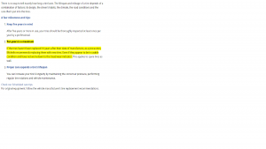

I have a 2016 tire (2) on my 2017. I'm trying to decide if I'm going to replace on DOT date + 5 or if in service date + 5 as I'm not sure how I feel about a tire sitting on a rack waiting to be mounted vs. one with weight on the wheels.
Feel free to share your DOT dates as I did to help awareness.
According to a document from Michelin, Tire aging is from date of MFG. tire aging.png
This page is from this document. When Do I Need New Tires? | Michelin.
