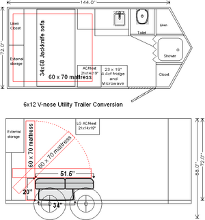

Why can't RV builders figure out the small trailer market?
A vehicle fits in a garage because you sit down in it. If you had an RV that fit in a garage, you wouldn't be able to stand up in it, which I assume you'd also complain about.
Here it is again. 6' ceiling. 7'4" total height.
You fit into your Chevy because you're sitting down, not your garage. Your garage door is probably 7'6" high. Your garage ceiling is probably close to 9'. Andre the Giant could walk under your garage door without hitting his head. He was only 7'4".

I understand that headroom is not important to you as much as other things. I believe that most people like the feeling of extra space, both around them to the side and above them. And apparently people are willing to pay for that space.
What I do agree is that roof mounted A/C units seem like a poor idea. Personally would love to have the mini split idea, much quieter and save on height.
Would also like to see the roof be very clear/clean, except for potential solar panels. Reduce the number of potential water leaks; no satellite dishes, no tv antenna, no A/C, no exhaust fans (vent those out the side), no sky lights - clean and clear.

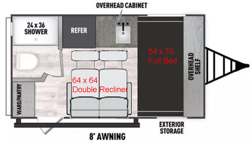

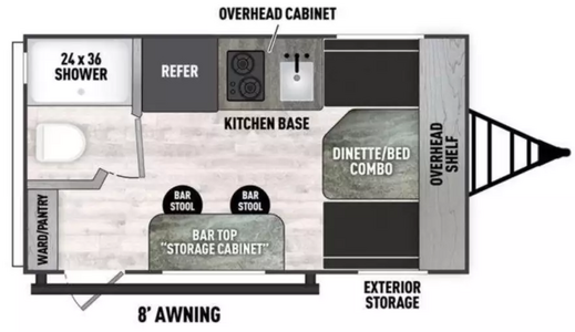

Here's what I'm talking about. The first picture is a brand new, $14K Coachman Clipper 14CR. Because you just can't have enough 3" cushions. Of course, it has the standard, requisite dinette up front, which converts to a miniature 48x68 inch, bed-like collection of 3" sofa cushions, for your night-time discomfort. On the side opposite the galley, it has that all-important bar, with a couple of really uncomfortable fold-up bar stools to sit on, just in case you forgot to convert your front nighttime sleep torture device into your daytime luncheon torture device.
But don't think I'm just picking on Coachman. I count 21 other nearly identical versions of this trailer, from every imaginable competitor. You can spend over $40,000 on this misery, if you're determined to get the best!
And you still need a pickup truck to tow it, and a storage lot to keep it, for the other 11 months of the year. On the bright side, you do get a dry bath and a decent-sized freezer, with a stove for all those gourmet dinners you'll be cooking, out there in camp wilderness. You even get a closet for your tee-shirts (provided you don't mind smashing them down a little, because it's too narrow for a standard-sized hangar). And, to top it all off, it even comes with that all-important 8' ceiling!
The 2nd picture is how I would redraw that floor plan. Instead of a dinette trying to pass for a midget's bed, mine has a real full-size bed that uses a real mattress, in a size you can buy anywhere. As a bonus, I get an enormous pass-through trunk underneath. But I had to give up the gourmet dinners (and the heavy propane tank) to get it. Instead of that silly bar, I have a double-recliner. It would have swiveling TV trays with drink holders, attached to the arms. Yes, it would have to be specially made to avoid the wheel well, but notice, there is plenty of room to fully recline while watching TV. Oh, and I fixed the closet, which merely required moving the door 6" to the right.
What you can't see is the 6' ceiling, which allows the unit to fit into a standard garage, while reducing the weight and air resistance, so that an SUV can tow it.
See how easy this is? Why are 21 different RV builders unable to figure this out?

Hubby is 6'3". A 6' ceiling ain't gonna cut it for him. Again, we all do want different things. I like my dinette and couch. Not much storage so I can't easily overload myself. Someday, when we are retired, we will want different things, but for now we like our Epro.

The smallest trailer they make weighs 6,000 pounds. The tow limit on my SUV (like most mid-size SUV's) is 3500.
Seems like you found your solution. Purchase the one RV, pull out the 2 items you don't like and replace with items you do like....problem solved.
That's the problem. I CAN'T pull out those two items and replace them. There's a giant wheel well in the way of the recliner, and I'd have to throw away the galley in order to install a normal-sized mattress, barely big enough for two for normal-sized Americans. Even then, I'd still be stuck with that 8' ceiling and that rooftop AC, so it would still be too heavy to pull with a mid-size SUV (not to mention, to tall to fit in my garage).

I like the Epro, too, but I'm not convinced we want different things. I just wonder, if Epro made a trailer where that Murphy bed converted into a recliner with TV trays, instead of a couch, and if that Epro actually fit into your garage -- would your hubby discover that he didn't mind bending over a little bit when he wasn't sleeping or eating or watching TV, if it saved him $1,000/year to own it? How about if it saved 5mpg while pulling it, and added 10,000 miles to the life of his SUV??
It's a tough call. I don't know what it's like to be a member of that less than 1% of the population who are over 6 ft tall. I just think it's kind of weird to design ALL little trailers for big people.
