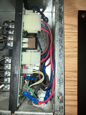

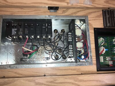

But that current isn't getting to the outlets, so doesn't that indicate a short somewhere?No it means there is current there (breaker on)
More likely an open, not a short. A short would no allow breaker reset!But that current isn't getting to the outlets, so doesn't that indicate a short somewhere?
Well so far I ly found one resettable and it won't reset, could have been replaced and the load and line were mixed up?More likely an open, not a short. A short would no allow breaker reset!
As an aside someplace in that rig you should have two master GFICs many outlets can be daisy chained per GFIC, but you should find two masters. (resetable/testable)
Look for an appliance that may be causing the problem.Well so far I ly found one resettable and it won't reset, could have been replaced and the load and line were mixed up?
Then and only then replace the gfci.Look for an appliance that may be causing the problem.
Make sure they are all unplugged.I don't understand all the appliances are plug in.
The GFIC rating is based on the amperage it will handle safely. If your breakers are 20 amp the devices/receptacles should be able to handle 20 amps. If the breaker is 15 amps then a 15 amp GFIC will be just fine, however a 20 amp will not hurt anything.
This will be true in anything on the down hill side of any breaker. The breaker protects wires and devices. To small wires or devices can cause a melt down. Small is determined by the breaker/fuse!
Do you get what I'm saying? If not I will try again!
I get it, as an example, the refrigerator breaker is 20 amps so in this case the 15 amp GFI outlet would not be enough to protect iit would need to be 20 amp or higher.
