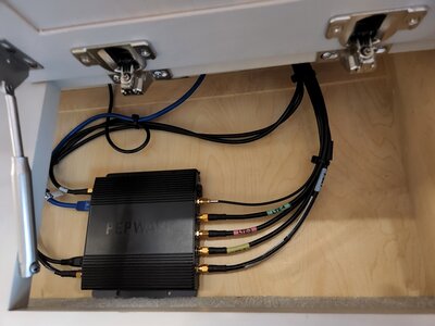

I put the Wi-Fi paddle antennas on and the Wi-Fi is night and day better. My android phone Wi-Fi signal test went from -90 to -54 by switching to the paddles, i.e. much stronger. Tests on the laptop verify.

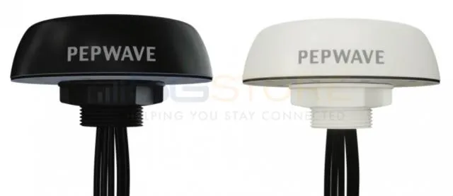

- Pepwave antennas are likely better as they are on 6.5ft leads instead of Parsec's 15ft leads. If I did this again I would go with Pepwave's 421 (4 cellular, 2 wifi, 1 gps).
- I recommend the Pepwave antennas over the Parsec but if you go with Parsec consider maybe a cellular only or cellular + gps or realize the wifi may not be ideal for inside the coach.

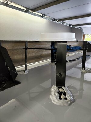

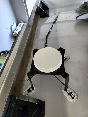

- Parsec appears to get better cellular connectivity. The pepwaves were elevated so I'm not going to attribute too much to antenna position. As I don't have both antennas available for side by side testing this takes away some merit from this conclusion as I can't test the same point in time.

- I'm leaving Pepwave 2's Wi-Fi to the roof Parsec for bringing in external Wi-Fi sources when available.
