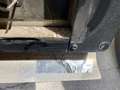

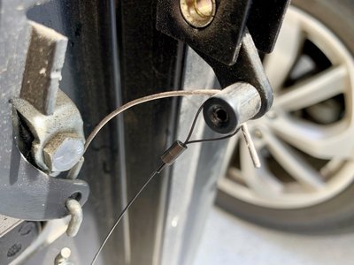

Yesterday morning I got everything ready to remove the electrics bay door one way or another. Double taped the edges to protect the paint etc.
Than decided to try the key again. Thinking if it breaks, the door latch is toast can be fixed later. After playing with it for couple minutes, I managed to overpower the actuator and it opened (y)(y). Replaced the 20A burned fuse and the latches work

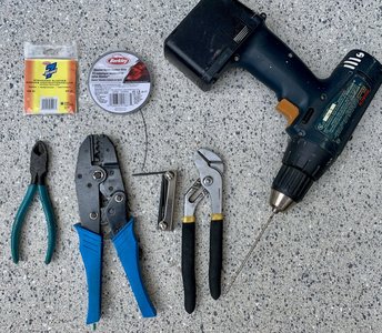

Now waiting for the new actuators and SS nylon coated fishing line and crimp sleeves to make emergency release for each door.
NEXT, will tackle the slide motor bolts and replace them with Nord-Lock washer / stud fix recommended by SLS in 2018 SLS Fix
I would love to see some photos of how you do this; especially how you hide the cables and where.
