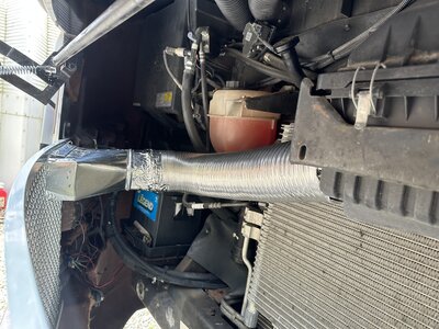

When I first got my Georgetown, it got about 6.5mpg at 55 mph. I made some modification to it and now get 8.5 to 9 mpg at 70 mph on my last trip of 2500 miles. I drive the same route a couple times a year to our "GO TO PLACE. "
First I did a cold air intake, a simple scoop at the front grill, directing air thu a dryer vent metal flex pipe to the intake of the stock air filter.

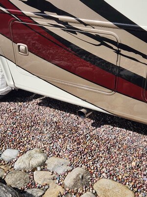

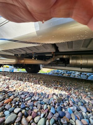

Secon, and the greatest improvement, was to shorten the exhaust pipe. Mine crossed over after the muffler to the driversders side from the passengers side. It now exits at midway on the passenger side. No increase in noise and about 10 foot of pipe and 100 lbs. I have also noticed less downshifting on steep grades, which I am smart enough not to be concerned about dropping speed down to 45 to get over in an attempt to keep the engine RPMs as low as possible. Remember your engine develops max Horsepower at about 4500 RPM, but it sucks a lot of gas.

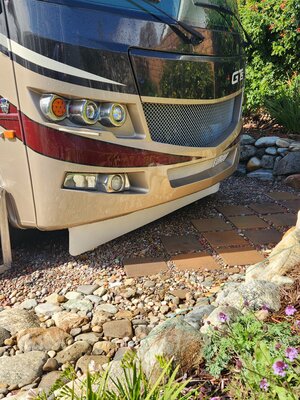

Third was an filler between the front grill and radiator support at the bottom of the radiator and an air dam below radiator cross member. othe front bumper, this improves air flow thru the radiator and, I believe, reduces front end air resistance. (not wind tunnel tested).

Are you talking about a straight pipe under the MH, or exiting out the side of MH
