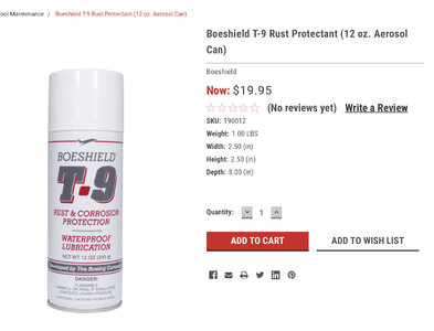

As to cleaning and lubing jacks, this is what the tech at HWH recommended:
