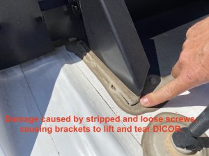

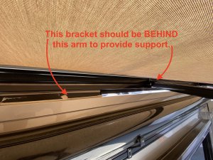

I took our '19 DS 4369 down to Girard for adjustment and minor fixing for some arm pivot screws that fell out. In the process of adjustment, they couldn't get the middle arm to the right level; it sagged below the two outter arms. Upon their inspection, THEY FOUND THAT THE MIDDLE BRACKET WAS MOUNTED IN THE WRONG LOCATION!!! Each bracket MUST BE DIRECTLY BEHIND EACH ARM!!

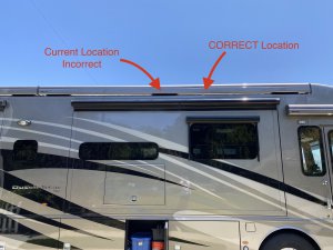

My forward awning has a center mount that is about 2 feet off. This causes the entire housing to warp when the awning is extended, since there is no support behind the center arm. The rear awning's center bracket is also incorrect, although not as bad.

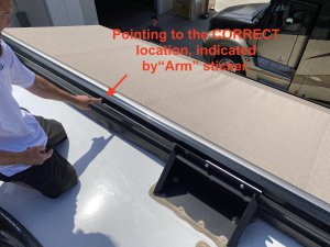

The center mounts DO NOT GO IN DEAD CENTER, but instead, are forward of center since that arm has to have clearance from the rear arm when they retract. This is specifically noted in their installation guide, along with the statement that any deviation will void the Warranty. Girard even makes it simple by placing a round sticker that is labeled "ARM" on the back side of the housing.
The repair turns my gut upside-down. Since there needs to be a reinforcement plate under the roof, we will most likely have to cut the roof open where the bracket is SUPPOSED to go. Otherwise, we chance just running screws into the very thin fiberglass and "balsa-wood" underlayment.
According to Girard, this isn't the first time it's happened and, in fact, the next day, someone came down with a Ventana with the same problem.
Newmar is going to pick up the tab on the repairs, obviously, but how this could happen is a baffling.

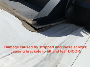

I'm posting this to HELP OTHERS, not as a bashing session on Newmar. Not fixing this will cause issues in the future for you. Also check your screws; most of mine were loose and a couple were stripped, which is causing the plates to lift up and even tear the Dicor. Make sure you extend the awning when you check for this issue.
