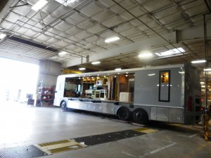

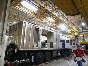

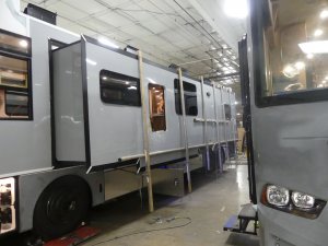

I think I would wait to see what the roof material is, plate or continuous aluminum, before making any assumptions. If it's continuous aluminum, a fourth plate installed with a piece of square tubing welded between the original and new one would probably do the trick.
I pulled up some photos of my build....they don't help much, but the aluminum in the picture could be rolled over the roof.
