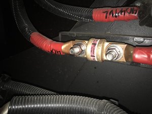

I was assuming you’re dry camping since you mentioned the generator is your power source. Here’s a picture of that 300 amp fuse in the battery bay. Ive blown it when I’m running too many appliances concurrently, microwave and AC’s for instance.

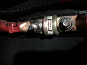

Here’s an old pic with cover off- I think it turned pink if blown

Found the 300amp fuse. Thanks @VTPete.
Looks fine to me.

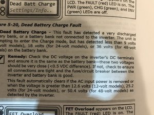

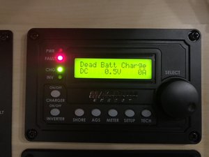

I’m looking at the Magnum manual for the fault showing. I’m thinking maybe my batteries are too low so the magnum is rejecting shore power, which is what why the watchdog isn’t throwing errors but instead just clicking off, then trying again a minute later.

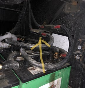

I can’t seem to get them to charge though. I turned in the generator, didn’t see them
Budge. Turned on the engine, nothing.
