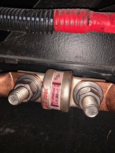

If you said 300amp fuse, you have won a chicken dinner. Picked one up today and replaced it just to see and voila.
Now, the question is "Why did the 300A fuse blow instead of a breaker tripping? When fuses blow (especially big ones), there is a reason and it would be well to find it. Just running a microwave and an air fryer at the same time should not be blowing a 300A fuse.
Glad you got it fixed. Hope it stays that way.
TJ
On the contrary. 300amps at 12VDC is not all that much when inverted.
120VAC at 28 Amps = 309 amps at 12 VDC
Quite easy to exceed 28 amps with those 2 appliances. Wait for shore power or generator for that much amperage.

Maybe this is the answer; my new replacement fuse!
Note the 3750A rating stamped on it! It came from a power company substation.
